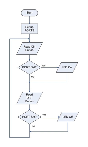

The flowchart shows how we check each button in turn and turn the led on or off. We then go around and repeat the tests.
We need two if constructions, one for each button.
